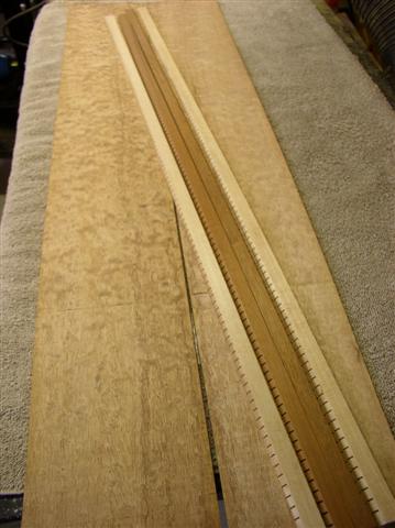

Here are the sides as they came from the Zootman -

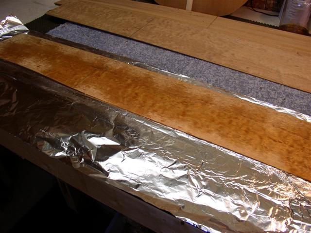

Here they are marked and wet, getting folded in foil.

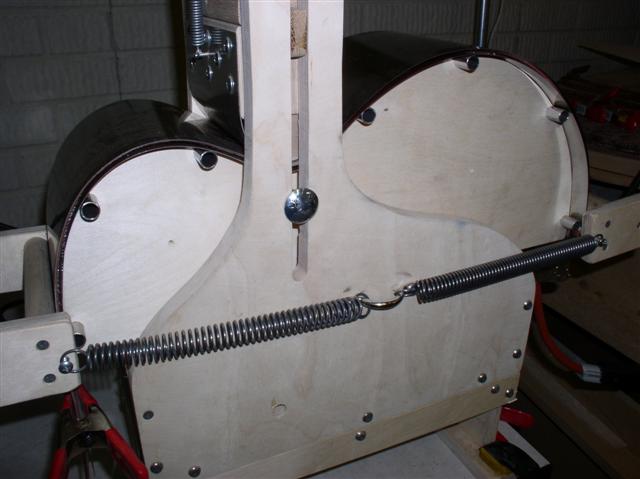

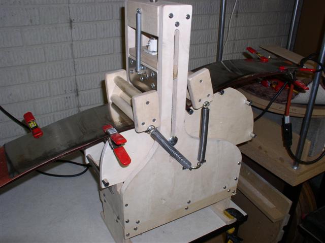

Now there loaded in the bender and bent -

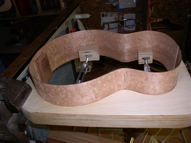

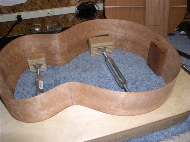

Here the sides are in the form, end block is glued in, and the neck block is next.

Looks great Lance. Yee what's up with the sides? I din't know you didn't profile first. I wanna see pic's of that process.
PostPosted: Sat Dec 10, 2005 10:51 pm
Posts: 8553
Yep - Ive always been gunshy about profiling first, fearing that the waist will fall in the wrong spot. So Ive always bent first and planed the profile in. Not a biggie, as Ill just trace the side shape on to the side and shave it down, takes about 10 minutes.LanceK38697.2860069444
PostPosted: Sun Dec 11, 2005 2:30 am
Lance...I agree with your rationale. I've used that method and should have stayed with it. Had I done so, I wouldn't have screwed up my last bend. Planing to a pre-marked profile is simple...being off by 1 inch at the waist can be problematic...and I'm still not sure if it can be corrected.
